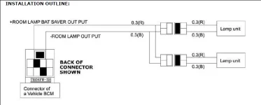

The reason I wanted to get the 2018+ kick plates is because all 4 are illuminated vs the ones for 2016 that have only the front illuminated. That being said the ones for 2018+ go for $150 (ebay oem 2018+ sill) with the harness (999Q9-36000) around $20 VS the full kit (2016+ illuminated sill) for the 2016 is $280.
The kit for the 2016 is plug n play direct to the factory. The one for 2018+ requires connecting the lights to the harness using positap and then plug the harness to the socket in the car (near passenger footwell).
I need to find the FSM for the 2018 to see if the socket in the passenger footwell is the same as the one for 2016.

I've attached the wiring diagram which shows how the sills connect to the harness.
I'm not comfortable tapping into the vehicle wiring especially since my vehicle is under warranty until next fall.

Did some more research to see if the set for the 2018+ QX80 will fit.
Apparently, the 2016 QX80 has the TH08FW-NH connector (4 pins on first row and 4 pins on second row) whilst the 2018/2019 QX80 has the TH12FW-NH connector (6 pins on first row and 6 pins on second row). The connector is in the front passenger side right footwell. Reference for connectors http://prd.sws.co.jp/components/series/pdf/jp/nh.pdf
So either I stick with the set for 2016 QX80 or I find a harness with the 8pins that can connect the set for the 2018+ QX80 to my 2016.
