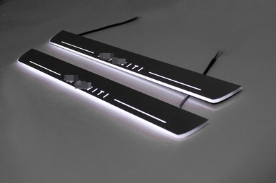

by any chance does anyone have the non OEM (ebay) illuminated kick plates installed?
I won that 7 pin trailer junction kit off ebay for 3.45 dollars shipped :)
What do you want to know about the kick plates? Ive got the Infiniti oem ones but they are all the same...
Sorry for delay. Am on holiday in Thailand but my dealer got back to me saying they don't carry the oem illuminated kick plates in Dubai. If I supply the part myself they can install but no warranty.
The installation looks pretty easy from the manual. Once you pop off the panel near passenger footwell how difficult is it to plug in the harness into the factory connector? Am planning to DIY.
Hey there.
I thnk i had ratio “add a fuse” on the passenger side. Seems newer models have a connector for these things form what I read in the instructions. Regardless, the install is easy peasy. I was able to do it with very little effort. All the pieces just pop off . You will have NO issues!!
Enjoy your holiday and no need to be sorry for the delay!
I'm still on the fence about this given the price.
The OEM ones cost $450 but have the plug installed making it easy install.
The ebay ones cost $99 and need a bit of wiring. Is it easy to tap into the factory wiring (pop off panel, splice wire)?
