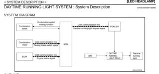

Is it possible to swap the qx80 headlights into the qx56 bumper? I went through other threads and it appears it may not be entirely plug and play due to the high been assist if you have a qx56 without high beam assist?
If you own 2011 to 2014 headlights, the 2015 headlights are somewhat plug-in and play. The plug is the same as the 2015 but the wires are slightly different. Meaning you could use the 2015 headlights but you will lose the DRL function. I believe that the AFS will still work as long as 2011 to 2014 QX came with it. You can make the DRL work by doing a little modifying. When I look at the service manual, the DRL is controlled by a CAN-signal sent by the BCM to the IPDM E/R (which is where your fuses and relays are). Based on the diagram from the service manual, the CAN signal that is sent is to tell the IPDM E/R to supply power to the DRL from the battery. One could get creative and bypass all of the systems by using a custom switch to supply the necessary 12v to DRL for them to come on. One way which is a clean way I think is to make a T-harness with the necessary power wires and relays to a switch inside the car to control the DRL and tie that into the car so that the DRL only runs when the car is on, but can still be controlled by a switch.
The QX80 headlights should fit the QX56 as far as fitment.
