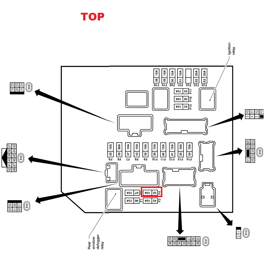

Those DTCs you pulled shouldn’t cause the start, then shut off or even hard start issues.
The premature failure of the IPDM relay or the entire IPDM was a common issue on the first gen trucks, especially from 04-07. The fuel pump assembly as well, was prone to failing but you’ve already ruled that out.
The IPDM is located in the engine, main fuse box.
Remove the ECM relay and swap in the fog relay.
See if anything improves after doing so.
