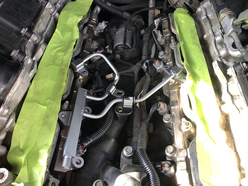

I removed the intake manifolds on my QX80 and my previous 04 Armada; the QX80 is hands down, much easier to remove. Unlike the first gens where the fuel rails and injectors sit outside the manifold, they're located under the intake manifold on the Y/Z62s so no worries having to do anything fuel related.
Besides the 10-(10mm bolts) that hold down the intake manifold, all I did was loosen/remove some of the other 10mm bolts that hold down the harnesses on the passenger side, towards the firewall. I did this because that corner bolt is a pain trying to get a socket on there. Also, you have to disconnect the pigtail for the MAP sensor on the back of the intake manifold.

The IM has 8 individual gaskets + 1 tb gasket. You'll want to replace those because you don't want to have to do it over again because of vacuum leaks. Also, torque the bolts to spec.

While the starter was in transit, I had my FX at the dealer for recall/service and the master mechanic and I had a chat about my QX project. He insisted I borrow/use a special wrench he had and I'm so glad he did. It was a Matco 15 degree offset box wrench (13/14mm), and while that allowed decent access to the starter bolts, they are torqued so tightly that I needed more leverage. I ended up finding a pipe at Home Depot that fit over the wrench, but was short enough to fit in the engine bay to where I could pop the bolts free.
That was by far the hardest part of the job.
Putting it back together wasn't that bad at all. She fired right up, but idled high. Backtrack to talking to the mechanic, he said 'don't touch your throttle body'. When I took it apart, I only unbolted the TB, and carefully laid it aside with everything still connected. Diagnosing the high idle, I did the pedal dance/ECM reset at least 10 times to no avail. Then I tried cleaning the TB, but it really wasn't that dirty at all. Then I tried the pedal dance again to no avail. Finally I gave up and took it to Infiniti hoping they could use the consult tool to reset it. They couldn't get it right either. The mechanic smoked the intake to make sure I put everything together properly and finally came to the conclusion that my throttle body was bad :( I found a new one on sale at an out of state Infiniti dealer for under $500 (no tax), got that installed and I'm back to running well. So kids, "don't touch your throttle body"! I noticed the TB went from part rev A all the way to D, so maybe Infiniti realized they made these things a little too hypersensitive.
