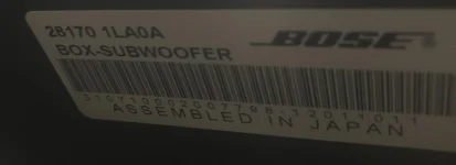

Well, I have been running the stock sub on an external amp and I must say the bass output has more than doubled. There are definitely times where I have to attenuate the bass (with a remote bass control knob) because depending on the song it sounds like I might blow them, Other songs take the full power and sound amazing. Overall I am happy with the mod but honestly I am biding time until I blow them and have a better excuse to put in a real sub in a custom fiberglass enclosure to fit the space.
As far as install wiring goes a couple of things to note about the 2012 vs the 2011 are the following...
Out of the Bose amp the wiring is Red positive and white negative.
At the speakers themselves, the colors flip to red negative and green positive. Don’t ask me why, but that is what they did.
Here are some pics...
more pics...
and back in the truck...
more pics...
I am seeing that the white is positive and the red is negative (coming from the Bose amp to thee subwoofers) in both the 2011 and 2014 AV service manuals.
