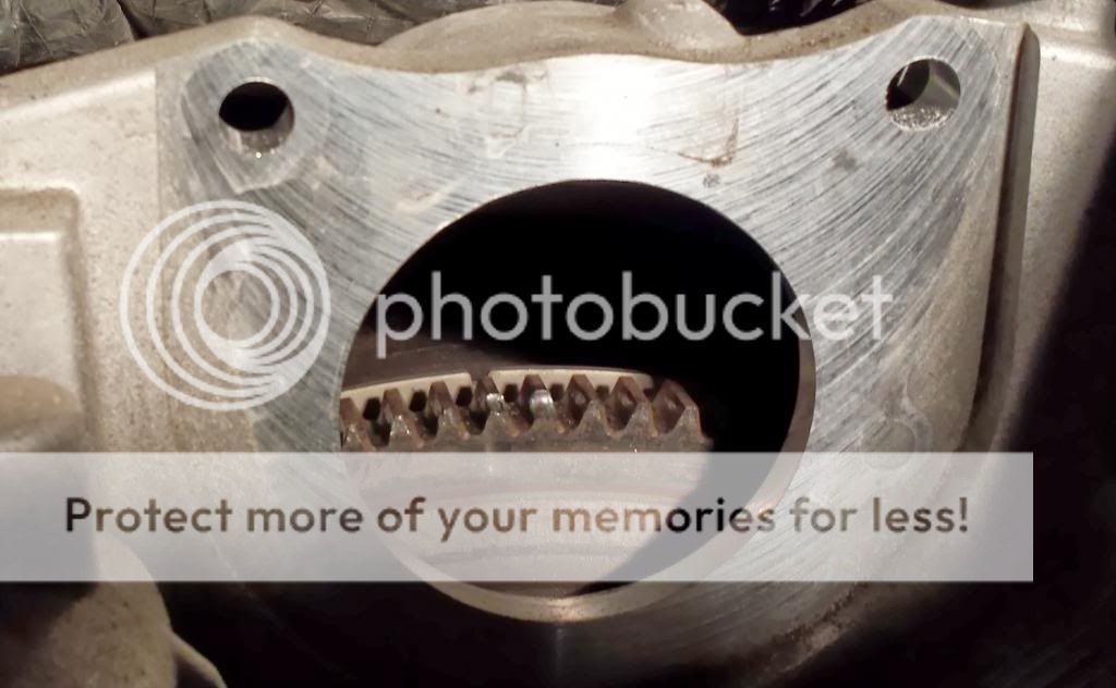

I removed the starter and found the starter gear was jammed on the fly wheel. When I pulled the starter out, a second later the starter gear "snapped' back to recess position.
I am guessing the wife tried to start it the second time while the flywheel was still spinning from the first start attempt.
I can replace the starter to be safe, no problem there. However, I found that two teeth on the flywheel had been slightly damaged. One about 1/4 the width of the tooth, and the other about 1/3 the width of the tooth.
It looks as though the starter gear will engage deeper then the damaged area, and obviously it should only start on this location of the flywheel periodically (1 in 100 starts?).
How serious is this? Should I likely be fine just cleaning up the the two teeth a little and installing the new starter? I can't remove the flywheel, I would have to pay big dollars for that kind of service.
