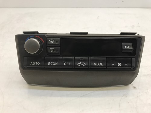

When I press on the button on the climate control taht controls the fan speed, it doesn't turn on the blower motor. theres no cold or hot air blowing. When I put power to the motor directly then it works, and I also tested for power at the connector and there is. I tried replacing the AC relay and the blower motor resistor, but they stopped working after I shut the car down and started it again. I checked all fuses and they are okay. I also tried getting a used cliate control module and tried replacing it but the fan speed buttons still do not work.
(For reference, I am talking about the bottom right button with arrows on it as in this picture: https://i.ebayimg.com/images/g/~QYAAOSw-0xYRKH6/s-l500.jpg)
Any tips on diag or repair if anyone has experience with this issue would be much appreciated!
